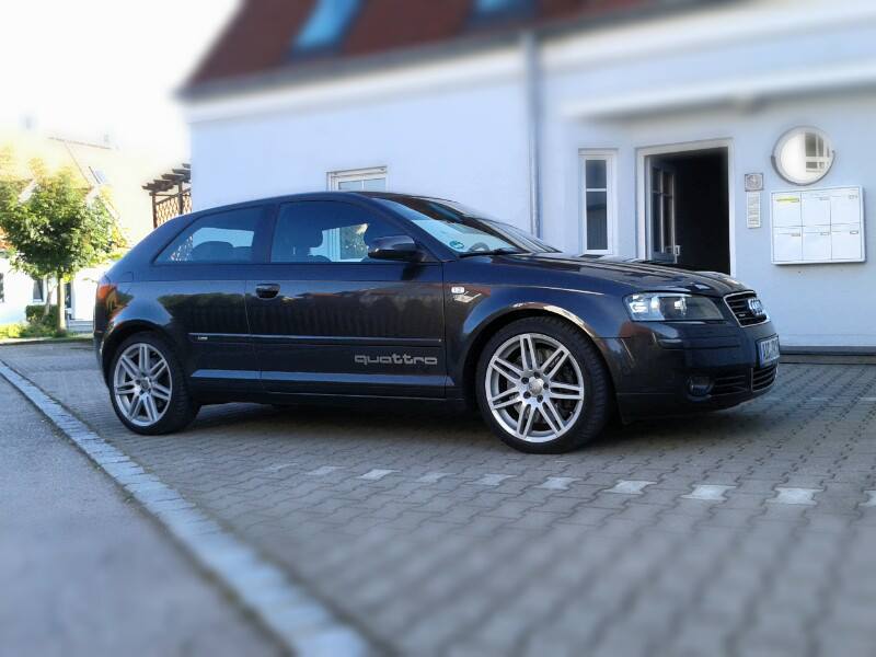

Wednesday, 3. July 2013, 09:32
Alte Aufkleber weg, neue Aufkleber dran. ^^
